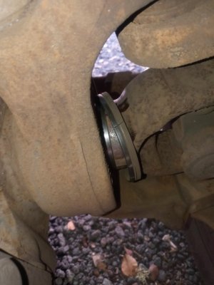

Jan 30, 2022 #1 J Josh mcqueen SDD Junior Member Joined Jan 30, 2022 Messages 1 Reaction score 0 Location Volcano hi 06 f350 has been driving a little rough, and we noticed this ring just hanging there on front passengers side. I assume it is suppose to be pressed up, but how do you reinstall it?
Feb 1, 2022 #2 DaveBen SDD Senior Member Joined May 31, 2005 Messages 9,622 Reaction score 81 Location Ukiah, California It is the oil seal for the front axle. Pull the axle and press it in (Hammer it in will work in a pinch).
